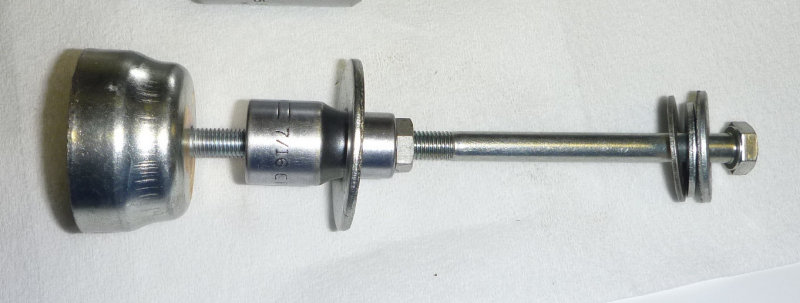

Get a 5/16 fine thread coupling nut & a short piece of 5/16" threaded rod . Screw the coupling nut onto the grease cap stub screw the threaded rod into the coupling nut . Then using another nut and a large fender washer or washers create yourself a small pulling tool to extract the grease cap .

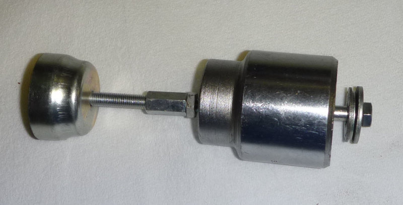

steveg
I based my slide-hammer Remover/Installer on a 5/16-24 coupling nut with appropriate bolt:
