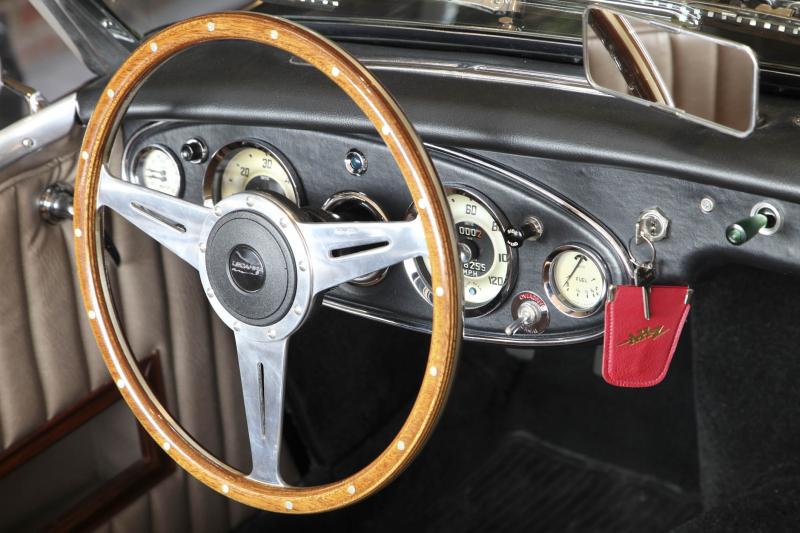

I have changed the dash on my 100/6 and in the process obviously I had to remove the Moto Lita wheel and boss
It was well on and the splines were slightly rusted so removing it required a puller
When everything was out, I greased the shaft and the boss so refitting was nice and smooth, however.........
Now I am concerned that it moves up and down on the spline very easily.
So the question is, how do I keep the boss and wheel fixed onto the spline and fully engaged at the end of it's travel up against the dash other than by the grace of god !!
Is there some sort of circlip that will hold it in place?
Thanks
Lee

Assume the wheel is the adjustable type. There should be a circling in a groove at the near end of the splined shaft. A good tool for tightening the collar is a rubber strap wrench.

The Moto Lita Boss that I have has two bolts that can be tightened so the boss grips the spline. There should also be a circlip at the top of the spline which prevents the Boss from sliding right off the spline.

Well I have no bolts or circlip on the spline, however I do have the circling groove so obviously there is something out there to stop it sliding off....I'll give Moto Lita acall Monday, maybe they can help
In the meantime any chance of any photographs?

Something is wrong there. Moto Lita have a boss for non-adjustable columns which does not have the tightening bolts. Your car appears to have an adjustable column but it looks like you have the non-adjustable boss. Or a boss for a completely different car!

That IS an adjustable column, so you need to get the correct boss from Moto-Lita, or a Healey parts supplier that carries them.

I have a similar adjustable boss. The turntable collar around the splines means it was probably made for the adjustable column, which you do have. Unscrew the collar completely from the boss, and you should be left with a slotted splined sleeve. Running the collar up the threads should tighten the collar onto the splines, the slots allowing for compression around the column. The slots may be clogged, or damaged, or the splines worn. Take it apart a little more, and clean it up.

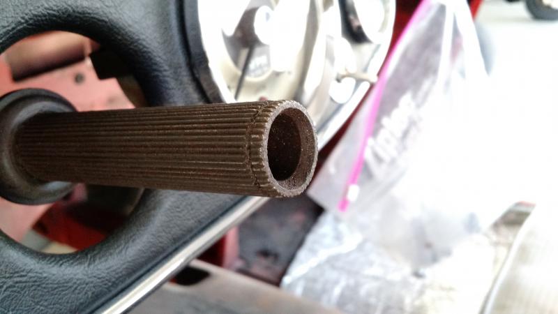

How can I tell if it had an adjustable column ?
In Randy's picture you can see the nut on the end of the column holding the wheel on. An adjustable column will not have that nut or threads, just a groove on the end for the circlip.

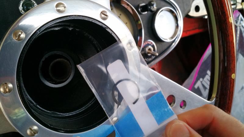

The end of an adjustable column looks like this:
The clip that goes in the groove to keep the boss from sliding off the splines:

Thanks Bob, Duane et al....it all makes sense now
The knurled nut that is designed to allow you to slacken off the pressure around the spline when you want to move the column up and down was rusted on so tight I could not move it
Now I understand how it works I have released it in the vice and will clean and lubricate and hopefully it will then grip once I put it back together
I will just need to get the circlip to prevent the wheel coming off the end of the column

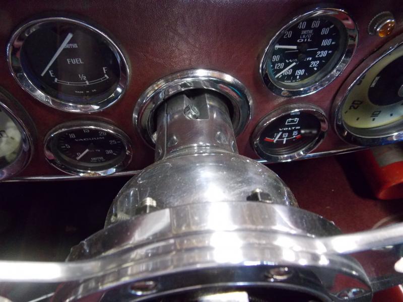

I had Moto Lita make a custom designed wheel for me to go on an adjustable column and it has 2 Allen head bolts so it can be tightened onto the steering column. From your photo it looks like you have an adjustable wheel which would lock itself onto the column by turning the big knurled ring. You should also have a circlip like I do on the end of the column to prevent the wheel coming off in your hands.

Lee, Mine looks just like yours. You have, IIRC, the Healey adjustable collar (or a repro) and a Moto-Lita boss. As you have discovered, the collar will unscrew so you can loosen and tighten the splines to move the wheel in and out. All you need is the circlip.
