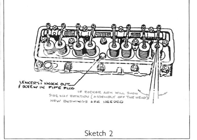

IMO the aluminum plug under the rocker cover is a more likely leak spot. At least that's where I would look first.

Hi Randall (and Dan), pulled the valve cover off but I am not sure where I should be looking to inspect that plug. Could someone help me located it please?

There's a raised circle in the casting, roughly centered fore/aft but over to the manifold side of the head. The top of the aluminum is milled level with the gasket surface, no slot or socket to remove it. Not certain, I think the factory threaded the plug into place, then milled it; but it might have been cast that way.
Edit: Here's a sketch from 'More BS' that might help

Found it but no obvious leaks there, but I haven't tried to clean the cylinder head yet. How do I determine if that is it? Would it be obvious is that was the point of failure?

That's a strange looking head! Low ports, no heater port, and looks like the stud holes are too small! Ferguson tractor?
Anyway, yes, that's the plug. Take a punch and hammer and tap on it in a few places. Should be solid as an aluminum rock. If you can dent it easily, it is probably rotted from the inside.

Randall, f that aluminum plug is well corroded and dents easily, can the plug be replaced without removing the head? Is there a special method to remove one that is eaten up (like mine)?

Sorry, Dan, one of the few things I've never had to tackle myself. I'm guessing that it's not hard to pry out the corroded plug (in pieces if necessary); then you need to run a pipe tap (3/4 NPT IIRC) in to clean up the threads, followed by installing a standard pipe plug with a smear of sealant on the threads. I don't see any reason it couldn't be done with the head on the engine, but you'd want to flush the engine thoroughly afterwards, with the radiator disconnected, to get out any stray chips that fell down inside the head. Packing the tap flutes with grease can help catch chips, but won't guarantee that none escape.
