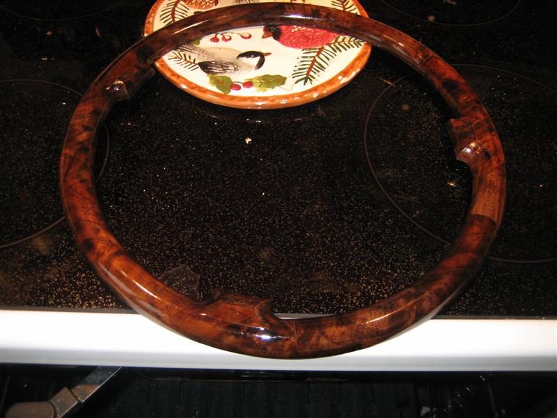

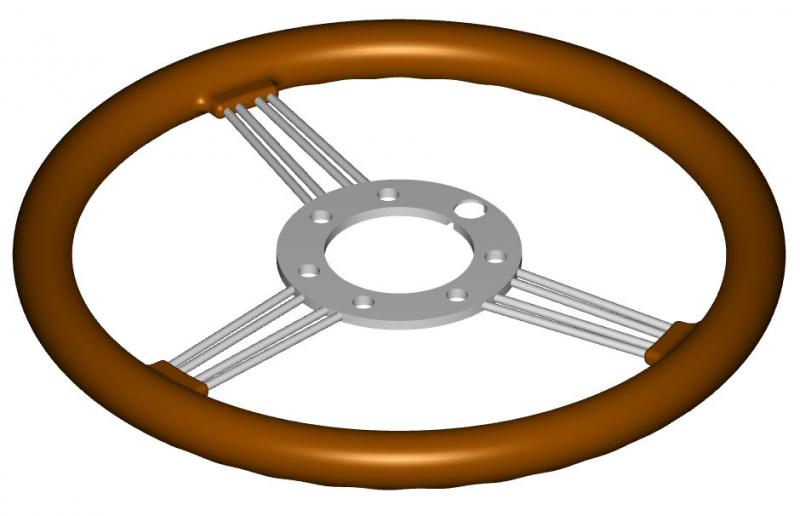

I am building a custom steering wheel for my TR6 and am using 17-4PH Stainless Steel rod for the spokes. I chose it for strength and corrosion resistance and am threading it. And probably a 308 or 316 for the hub.
