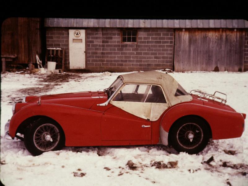

I won' even attempt to argue that the TR3 is comfortable in any weather that is not basically clear and between 68 and 72 degrees F. However, I drove mine winter and summer in northern New England for ten years never once was I hospitalized for frostbite. I still have the Amco ski rack. The stock heater kept me alive in temperatures down to about -20 F. Below that the car usually didn't start. (I once prematurely ended a promising relationship by forgetting to open the passenger heater door).
The defrost kept a spot on the windshield clear enough to see ahead, even in a snowstorm, if augmented with a swipe with a gloved hand occasionally. When things warmed up to 60ish, that tap had to be closed even with the blower off, if the top and curtains were up and in place, or it would get unbearably warm.
I thought this was all part of the Triumph experience. Have we all become wimps?
Tom
